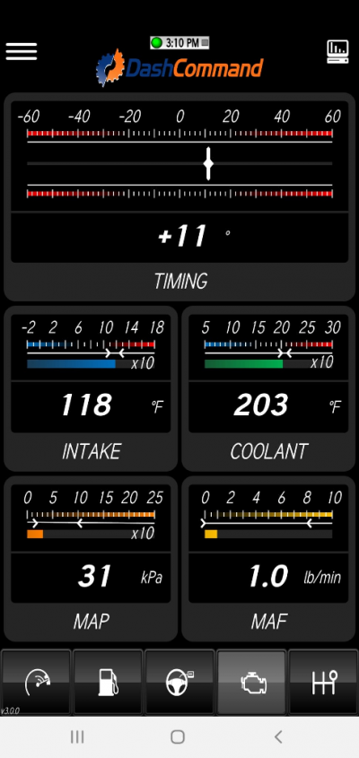

So I plugged in an obd sensor to see what was going on yesterday and noticed super retarded ignition timing! 10-24 ATDC!! Is this possible or is the OBD unit faulty?
Here is a shot of the timing low/high cruising around town- yesterday I did notice it more like 5-15 but not sure if that was btdc or not.. fwiw the truck seems to drive ok -but when I tow is embarrassing - even a small 18ft boat makes it hardly accelerate up a turnpike ramp :/ it just makes a noise upfront but not much happening to the wheels!

We're these snapshots taken at the same RPM and if so what RPM? With the map at 29kpa this looks like you are sitting at idle rpm
29kpa converts to 21.02inhg which looks like you are at idle.

believe it was taken at idle - i have a scanner on the way - hopefully it will enable me to check some deeper codes etc.. it has a graph system so ill be able to record multiple data points while driving-
