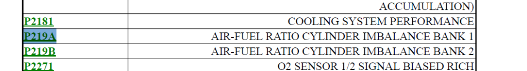

There's a actually a ton that goes in a p219A/B code. It's a lot more complicated than just possibly an injector issue. Things such as the evap purge valve and even mechanical failure on that bank.
