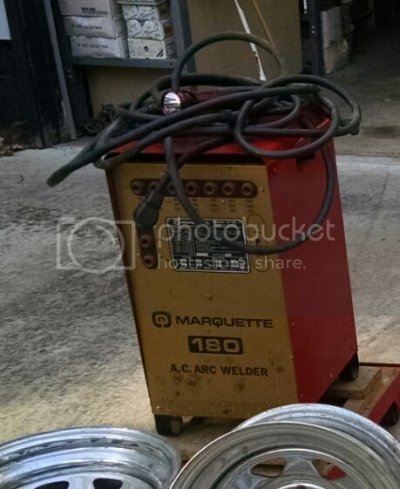

Hey guys,
I'm getting close to starting this winch project but I'm stuck on what I should do with this old Marquette 180 AC welder. I can't find the leads for it and nobody makes the right size plug anymore so I can't easily make my own. My choices are:
A) find the original leads which might take a while
B) MacGyver some leads with some smaller diam plugs and 3/8" copper tubing
C) forget about it and get a Miller Thunderbolt XL 225/150 AC/DC or the Hobart equivalent
Even if I get some working leads it only does AC and I keep reading that DC is better especially for a beginner. Any advice from the welding experts?
Thanks,
John

Sorry I don't have a lot of advice for you on this I haven't stick welded in years. The machine I have I beleieve is a ac only Lincoln and it works great. The only advice I can give you is to practice and pick your welding rod for your spesific needs. I did a quick search and there are a few pointers on millers web page about ac vs dc and dc reverse has a higher penetrateion over ac witch would be helpful for what you are Doing. You will need to do a quick search on withch series rod you will need if you forget to 6011 is a great general purpose rod. Your rod selection will play a big role in the success of this project.

Thanks for the tips. I ended up piecing together some leads this weekend, they're not very long but they're heavy duty and should work for now. Also picked up some 6011 and scrap to practice with. Just need a helmet and a design and I should be good to go. :)

If you can keep your welding flat or horizontal ( just not vertical ) look into the 70 series rods 7014-7018 they are a good rod and make really pretty beads and have easy **** removal. I did a quick search on the 7014 because I love that series and a lot of people seem to use the 7018 (I don't have any experience with it) but they are both low hydrogen rods and have easy clean up and a very pretty bead. Another hint go slower than you think you should. A lot of new welder I always see move to fast. Let once you see a good puddle try to keep it the same thickness, just be patient with it.
