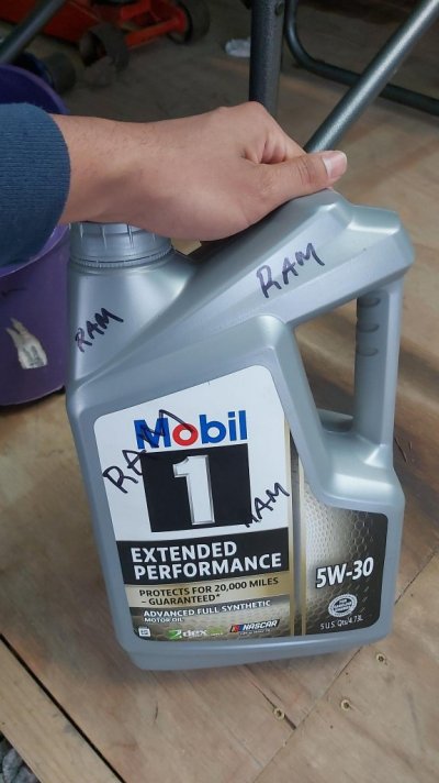

Currently overseas and my wife sends me a video of her 2016 Ram 5.7 with only 52,000 miles on it and it's making a racket. She said she was driving home and suddenly heard a loud tick sound and the truck lost a little power. She drove it the additional 5 miles to the house and parked it. Never had a lifter tick before. Mobil one 5-30 and the same Mopar factory filters and Mobil 1 filters I use on my Scat Pack Challenger. I have changed the oil and filter regularly in the truck 12 times. I'm obsessive and keep great records. I even changed it once because I was bored! No mods. It's my wife's truck and she drives like a normal human being. I can only figure defective part . its about 3 months out of warranty. I guess I'll tear into it when I get home in 30 days. I know it's a tired subject but I think mine is a little different in that it was driven only 52,000 miles. I'd enjoy hear everyone's thoughts on a 52,000 mile truck that wiped a lifter. Have you seen a low mileage truck wipe one out like this before?
