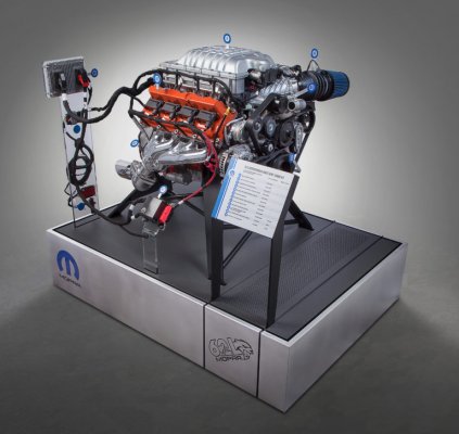

Because of the OP's concerns/issues, I use this religiously along with PUP 5w-20 and Genuine Mopar 5038041AA Oil Filter (used on Viper etc.) This is also one of the reasons why I still have stock exhaust-so I can HEAR any "ticking". My motto is "if it's not broke don't fix it" but later down the line a supercharged 6.2 is going in my Ram (no MDS lifters) if it's last thing I do! But for now I'll keep babying this one.
Every oil change! Like feeding a deer corn!
