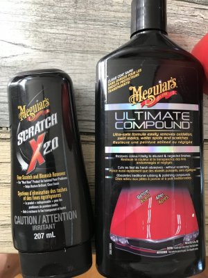

I see you got some great advice so far, but what Meguiars products have you tried? Some are pretty light grit, others are meant specifically for leveling paint.
