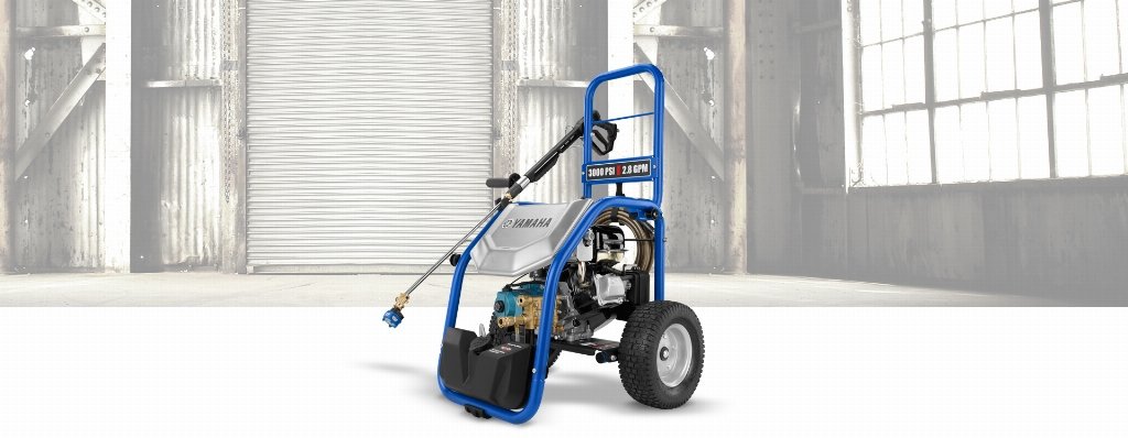

I researched pressure washers for months trying to figure out the best, or at least a good one. I ended with a Yamaha PW3028. Not the cheapest, but has great features, including an auto idle down.
Most all have idle down when the wand trigger isn't pulled, but it's a nice unit. Cat triplex pump which is the better style pump for frequent use and I've found yamaha engines better than honda in the generators I've had so I agree it's a good machine. It's priced similar to all the 6hp with triplex pump machines. How good are the hoses it comes with? The ones with axial pumps are 1/2.the price and the same output, but they last 1/2 or less as long.
