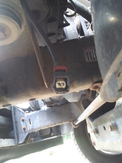

While cking my Horn location I found these two connectors just hanging to drivers side of the elect fan. Then I couldnt seem to see any horn. But still have the sound when i hit the string wheel pad .
I noticed that its not as great as it was when i got the truck. also when i press the FOB to lock up there is barely any sound Hope some ass didnt nic a part of my horn system20211111_105714.jpgany sound.
I hope someone didnt nic my horn ?!!

Fuse #45 in your fusebox, 20 amp fuse is the horn relay fuse. U might want and check if fuse still good. As far as horn still there, it should be an upper/lower dual horn mounted in there.,. Hmmmm, hope U still got yer horn, LOL

I still have some semblance of a Horn sound Could the relay just be crapping out ?
Are these connectors (in photos) for the horn itself ?

The second picture you posted looks like the ambient air temperature sensor.

Copy on the Temp sensor . so that should be just re mounted from where ever it slipped off.
Looking around at Google and connector pics it appears the other connector is an ABS but am finding similar for horn as well. No ABS idiot light is on though

I looked around behind the headlamp assy and the horns are there.
Seems the conn was attached to an inner panel since it has a white plastic threaded stud on it .
Could this connector be for auxillary fog lights power ? its hangs down near the drivers vent where fog light would go.
My issue is I never noticed these two hanging there before and i do look around when underneath . Just want to make sure if something got disconnected it gets reconnect etc before i do a cross country run
