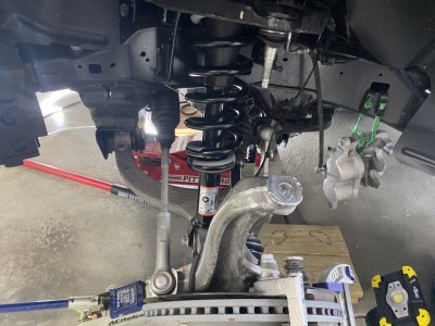

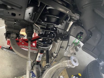

installed a motofab 2” Level kit. Got the kit on and strut reinstalled. Top nuts on, not tight and lower strut bolt in but not tight. The hub will swing side to side but won’t budge up. Can’t move it so I can’t reattach the tie rod, sway or UCA. Tried to jack it up but it literally starts raising the truck off the stands.
What did I do wrong ? And better yet, how do I fix it.

What if u put the jack where the fork of the coilover is on the LCA and jack up slowly to compress it.
