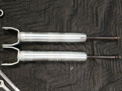

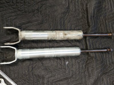

I've been trying out a bunch of different suspension parts for a friend (full disclosure I have zero financial or business relationship and don't mix money with friendship as a rule, he runs a 4x4 outfitter that's been successful supplying upgrades for a different platform and wants to branch out to support Rams too) and I'm getting ready to put my Bilsteins back on now that I'm done testing the latest round - well I wasn't gonna put them back on all dirty!
