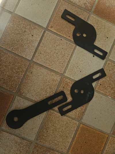

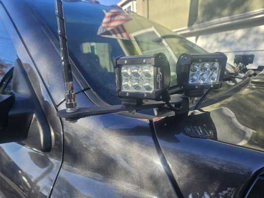

I added to my existing Ditch Light Brackets with the single LED Pods that I put on last weekend.
I added extender plates that allow for two LED Pods on each Ditch Light Bracket (for a total of 4 LED Pods) and also added the CB Antenna mount/extender. I then added the Firestik base/coax and 3 foot Firestik. See pictures.
Two pods per side. They are wired left and right so I can spot one side or both sides independently.
Next week I'm adding the UHF antenna extender and the UHF antenna on the Drivers side.
Once I have that antenna on, and everything is exactly where I want it, I'll paint the bolts with flat black Rust-O-Leum.
Mounting hardware (last picture):
- dual LED pod adaptor plates $35
- CB antenna mounting adaptor $24

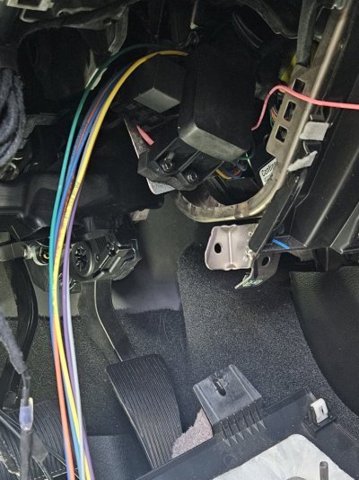

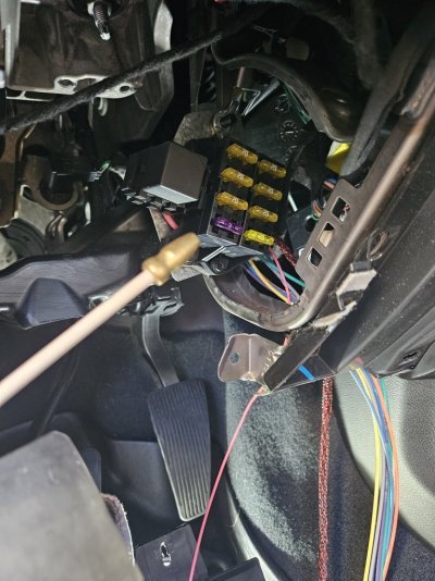

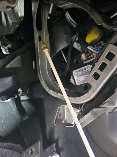

Fuse Box under the dash (instead of running more wires through the firewall).
Last week, I also installed a Painless Fuse Block (has relay, 3 constant and 4 switched) under the dash.
I plan on pulling the relay switched power from the brake light pedal wiring. It's 3 amp.
Positive will run back through the firewall to the the battery. It comes with an inline fuse.
For all of you "hobbyist" out there.... I know I could have put this together from scratch, cheaper, but considering the cost of wiring and >>>> time, this is a great value to just "get-er done!"
I am very satisfied with the quality of assembly/workmanship and all of the wires are ----> labeled as well as have more than sufficient length. It actually was more/better than I expected. This will make wiring up my Dash Cam, CB, other in-cab stuff.................... easier.
This block is the perfect size. LIKE IT WAS MEANT TO GO RIGHT THERE.
No drilling required. Hole was perfect where it existed on the dashboard frame right forward of the center console.
I fabricated the backing plate from a simple piece of 24 Guage plate. Used a big wing nut on the mounting bolt for ease of removal for access back past it in the future. Back past meaning to under center dash past the ignition button.
