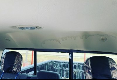

I purchased my 2019 Ram 1500 Tradesman brand new from the Dodge dealership. Nothing but issues. The biggest one is the rear window. The original had cracks on the moulding ( the plastic kind of rim where the top meets the headliner where the rear passenger airbags are located above where you would sit) so I brought it in because I noticed that when I washed the truck the rear passenger door was leaking. I assumed it was a seal on the door window. The technician ended up finding the leak on the rear sliding window- I didn’t see it. So okay. They take a steam cleaner or something I assume to the headliner and “clean” the stain- it was still visible to me but we replaced the window and I’m so tired of the headache of having my truck in, I decided later I could clean it better myself. So get the truck home with the new window and it pours so I go out just to check and lo and behold, it’s leaking. I’ll attach a photo of the headliner but I saw it and I full on said this is not acceptable and I want this replaced. My truck smells wet, my seat has gotten wet and they don’t seem concerned about the fact that the stain extends out past my airbags and speakers there. They say that if there were a problem the code would come it. Sure trust my passengers airbags to a “code”. First dodge said no replacement for the headliner, but they’ll clean it. Now, I’m waiting on a THIRD rear window, the last took 2 months to come in. They say this second one I had installed by DODGE had a hairline fracture. Nothing touched that window. Not the original, not the second window. So I suggested that maybe there was something wrong with the frame of the truck? Like why are my windows cracking and leaking?!!! I’ve been so understanding with the service ladies at the desk because I’m sure they deal with unhappy people a lot but this is ridiculous. I had the blower motor replaced because it constantly whistled. They replaced it and the noise is back. I bought the extended warranty for the truck but at this point, I want a Ford and I’m contemplating losing the money on this truck I bought brand new. What are my options at this point? Do I want another Dodge? Not really TBH. I hardly have this truck anymore. It’s always in the shop. Now it’s sitting here at my place getting wetter and wetter. Probably for another two
Months until I get another faulty window in. They’re lucky I have a little car but it wouldn’t even start this morning so now I’m forced to use this truck and put more kilometres on it in the meantime. What would you guys do? I’m so tired of this. I was so excited for my first new vehicle and I wish I had never laid eyes on it.

Not much you can do unless you contact an attorney and start a lemon claim. That’s what I’d do anyway. Especially since it will take so long to repair, and the weather doesn’t stop. You could take a hit on the truck value if you wanted. But all these trucks, Ford, Chevy they all have their own issues. Just go to their forums and they are filled with complaints. Mine hasn’t leaked once so there are good ones out there. Sorry to hear this. Contact ram cares on here. They help if they can.
That doesn't look like it coming from the window. Check the Seal on your 3rd brake light. I just replaced it with weather stripping and hadn't had any issues since.

I wholeheartedly concur with Mattcham. Third brake light leak appears to be the culprit....
Agreed, or maybe even an xm antenna leaking issue? I thought I saw a few people that had issues with them on here. Either way, would be weird for that much water to "leak up" like that.
And if that's the case, maybe look for a better dealer cause this one seems fixated on just replacing the window each time.

right?!!! I told them it was odd that the water had travelled the way it did. They claimed it’s because the fabric is soaking up the water and that’s why it’s moved so far along. I don’t know what they do with the vehicle in the shop when it’s back there. My first suggestion was that it was a seal somewhere as I had seen so many of these leaks from seals on the forum. I also asked about the ANC Module when I was having the roaring issue in the cab and they dismissed me and yet lo and behold they finally updated it and yes, it seems that is was the module. I guess I was under the impression that they’re looking for these things which is what anyone should be doing. I did contact RAMCARE and I made a case with them. I guess I was just trying to be too nice but now, I’m starting to realize that yes, they should be providing me with some sort of vehicle in the meantime and why the hell is my truck sitting out in the weather now for something that is THEIR FAULT! I really hope something comes through when ramcare calls tomorrow. Now, I’ve got more things to worry about- will
It rust under there in the future? Are my air bags damaged? I better get a brand new headliner. Do you guys talk directly with the mechanics or technicians? I don’t like to use this truck for Travelling to work as I work for construction and there are so many damages on site that no one is accountable for when it comes to personal vehicles. But now, my little old

I said what my issue was. Noticed it after a week of having the truck. Took the 3rd brake light off an took the crappy gasket off and put a better one..no water leak ever since

The dealership technicians represent the dealership - they are not owned by RAM but are franchisees.
That is one reason why there are such differences in quality between dealerships.
But to be honest, auto technicians are like every other profession - you have a percentage of really poor ones, a large percentage of average ones, and a small percentage of really good technicians.
I wouldn't hesitate to go to another dealer if there is one local to you.
It is possible,
A. the replacement window wasn't installed correctly or more likely
B.the original cracked trim was just that, cracked trim, and not the source of the leak.
I would get a refillable container of Damprid and just put it in the truck - it will absorb moisture - I would definitely do this after they fix the leak.
