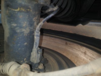

Was crawling around under my truck today and noticed this line or hose was cut and taped up. It comes off the rear brakes. Since ive had the truck ive swapped the out shocks to bilsteins and last year i had to replace bearing in rearend. Possible times it couldve been cut. I know its not the brake line. A vaccum hose possibly?

That's your abs line.

Ok thanks. Maybe thats why i almost totaled my truck when i hydroplaned a few months ago. I turned away from the wall and hit the brakes and instantly felt like i was on ice straight to the wall. Luckilly my front tire being turned to the right hit the wall first and bounced me off before any of the truck hit. I cant stand putting my truck in shops. Everytime i do i find a problem after getting it out. When i had the bilsteins installed, they didnt put the rear shocks. Luckily i crawled under and noticed it the next day. I had the driver side exhaust manifold bolts changed at a shop(i did the passenger side myself) and they left a vaccum hose disconnected to a valve under my battery. Cant remember what its called. I fixed that. And now this. Its like you almost have to go through your whole truck after taking it to a shop. F****** ridiculous the service you get these days. And these were all 3 different mechanics.

Is your abs warning light on? I believe it should be. It's an ABS sensor wire. Whoever taped it together, obviously knew they cut it.

No its not on. Thats what i was wondering is if it would throw a code. Yeah i mean atleast they taped it up out of the nice and neat haha! *******... Do you think they would do this to change out the shocks when i swapped to bilsteins?

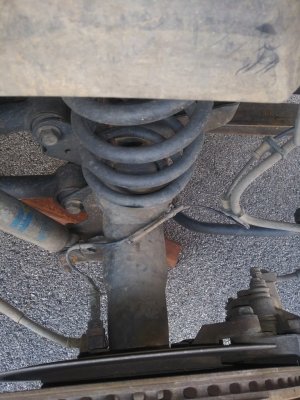

The actual line doesn't look cut to me. Looks like they used it to keep the line tight or straight in the clamp or maybe to keep from working it's way into the spring and getting damaged. But from the pictures I dont see where the mainline has been repaired.

I see what you are saying. It does look like there a cut hose in there thats taped to the abs line. I will crawl under and check again tomorow. Good eye sir!

That’s what I thought. Looks like chafe tape. Little preventive maint. I do it to stuff on mine all the time
