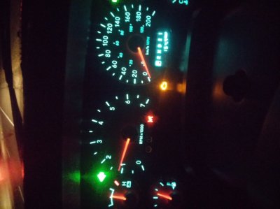

Fired up thiS morning to a check engine light. Got ten km down the road and this lightning bolt pops up and truck starts dying.

Here's the pic

The lightning bolt is the fly-by-wire TB error with the Electronic Throttle Control system. i cant tell you how to fix it though. Got a code reader? I have read elsewhere that cleaning your throttle body has fixed that code for other people.

That light is for your TPSA. More than likely it's gone bad, the truck starts to die because it's not communicating with the computer and is not staying open enough to make the right amount of air/fuel mixture.
