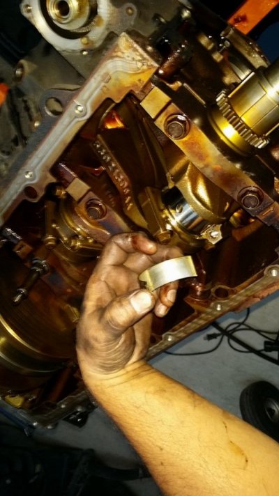

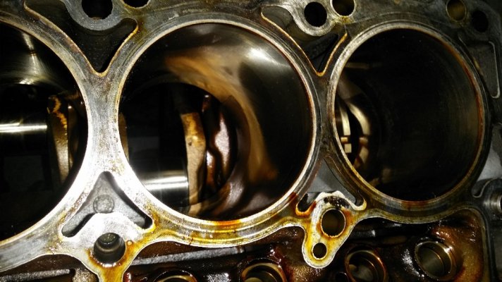

I run Amsoil 0w-30 signature series...truck has over 308k miles and motor looked pristine when I opened her up a couple years ago...
