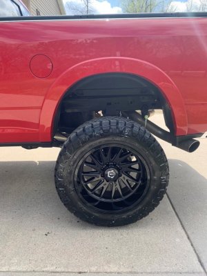

I have a 2019 Bighorn with a 6" Procomp lift. I am running 22"x10 Fuel Contras with 37x12.5x22 Nitto Ridge Grapplers. Some trimming on plastic was done. But that's it.
Good thing about 4x4s is that you guys sit nigher than the 2wds do .... your 6" is basically the 7" on my truck but just a bit higher clearance in the front because of the coilovers ...
