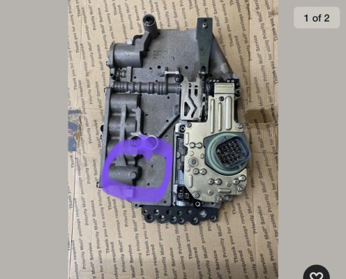

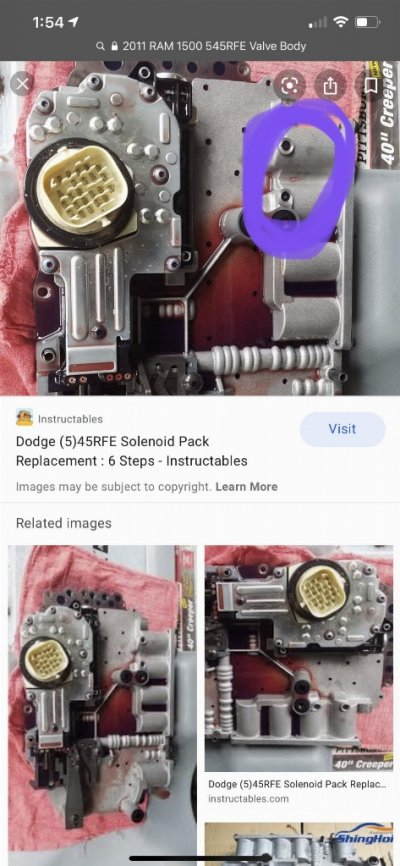

I just may have found my issue.
I looked online for a 65RFE valve body and a 545RFE valve body as my mind was telling me to look and see if there’s a difference, and i think i just found out what’s wrong
I MAY have got the wrong valve body. I don’t know if they’re compatible, but i notice a few things that are different, such as:5d3f45c1dd70f0eac15d08ba459e5150.jpg
My original valve body doesn’t have the two black dots on top of the accumulators that i can only think of as being bleed off valves. Could this be an issue that i need to take up with the eBay seller?
Sent from Blue Onyx
Burla
Apr 28, 2012
27,745
58,198
2010 Hemi Reg Cab 4x4
I'd ask him. Did he refund your SP?
TheEnder
TheEnder
Aug 12, 2017
2,093
1,653
4.7L V8
Yeah, he did, and he still shipped the SP. Great seller, the sp is coming in tomorrow. I think the 2 valve bodies are different personally. I still have the old VB to go back to luckily.

Yeah, really cool. I wasn’t expecting that. Anyways, i’m gonna put back in the old VB tonight and pray no more vb screws break. Wish me luck.

Which valve body do you have OEM and which valve body did you order?
Burla
Apr 28, 2012
27,745
58,198
Wait, dude really? New SP and old VB? Let's find out what those are.
TheEnder
TheEnder
Aug 12, 2017
2,093
1,653
4.7L V8
From the 2 pics i sent earlier, i have the one on top that came with the truck from the factory and the one on the bottom is the one the eBay seller sent me.
Sent from Blue Onyx
Burla
Apr 28, 2012
27,745
58,198
Is that a one way pressure valve, like a bike tire?
Burla
Apr 28, 2012
27,745
58,198
Sent from Blue Onyx
I meant you have a 545rfe VB and you ordered a 545VB?
