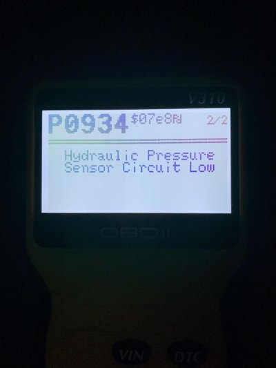

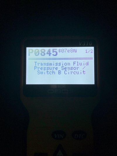

Slightly binding on shifts, it’s clicking pretty badly still on the 1-2 shift now, and it’s setting 2 codes. P0934 and P0845.1b5017b8bdbbcb79e78c235059ac61a1.jpg

one more time, symptoms after new VB?
Transmission not shifting past 2nd gear
Codes P0845 and P0934
Clicking when shifting into 2nd
No limp home mode
