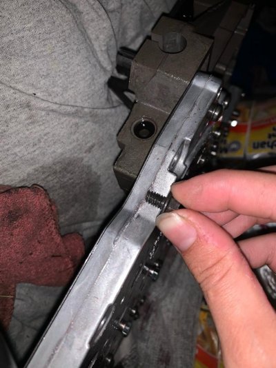

I have good news regarding the broken valve body bolt. 9ffd68d87916dc515ff2790dd1bd1684.jpg
Looks like i’ll just be able to take a pair of vise grips to the remaining bolt in the trans, that is a relief.

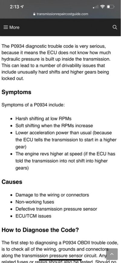

@Burla, I got codes P0845 and P0934 now.

I cleared the codes and reseated the battery connector and put more fluid in, and the P0845 code (knock on wood) cleared itself. 8799e418a37724452f3deabeb7166efa.jpg
Maybe the line pressure sensor that broke earlier is broken again? That would explain everything!
Edit: P0845 is back.
Second Edit: I just read that it’s possibly the pressure sensor in the solenoid pack. Guess it’s still bad.
Sent from Blue Onyx
