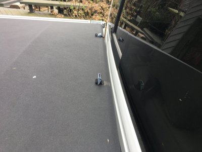

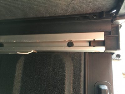

I just purchased this 2011 with Rambox a few weeks ago from a dealer. They had no info on this Tonneau Cover and I can’t quite figure it out.
Short of unbolting it all together...I don’t see way of lifting it up or retracting it or anything.
Anyone familiar with this cover??

Looks like the type that “peel” out of the channel and roll up. Then the cross bars pop out. You leave the track in place.

I agree with CincyCuda68, it looks like a “roll up” cover. Slightly different design than mine which uses Velcro on the sides, but same operating principal. The cover “peels” off and rolls forward, the track/rails remain in place.

Looks more like a trifold to me. It has cross bars and it also has buckles at the front so you can strap it down while driving with it open. Do you have any pictures at the back? (Near the tailgate) specifically any latches or quick releases

That notched out corner, start there and pull the piping upward. It should peel right out of that channel. Go across the tailgate first then do your sides and roll it up.

Yep...it’s the peel back roll up type.
