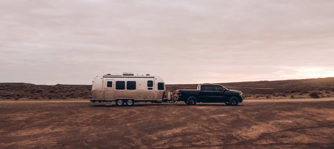

What a truck can tow isn't always what the driver behind the wheel who's responsible for how the trailer is set up and loaded is capable of.
You need a 4500 ram! Your 1500 is not designed to tow!
only a 4500??
more like this...
