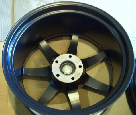

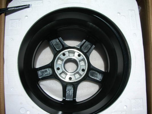

Do your wheels have any bores or a dished out area at all ?
Or is it flat all the way around ?
Did you get hub & wheel centric spacers ? Bora is a great brand imo
AustinB
Banned
Sep 8, 2015
3,942
2,053
San Diego, Left Coast
I will try my best and see if I am translating what RLK is trying to ask.
(Correct me if I'm wrong)
On the inside of your wheels, where the lugs go... Are there bored out areas beside the holes or is it smooth?
Bored out "areas"
Smooth (nothing between the holes)
I think what he's getting at is that the exposed lugs with go into the bored area and not hit anything.
Again, taking a guess here.
