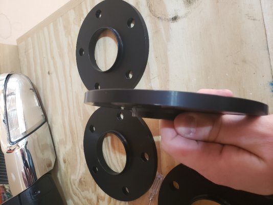

I test fit a 1/2 in cheapo spacer and it fit perfect so I'll get the good ones ordered. Only issue now is the lug nuts I have are super long lol. So I want to see if I can find some like 1in long black lug nuts.
There's a reason cheap isn't always right. Order the aluminum version of bora and you'll be fine. 3365bc3bb7da76dbd3e0180e3598fb73.jpg

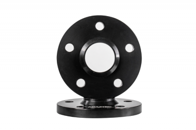

Yep, I ordered the .5in BORA ones from Motorsport-tech. The only thing I'm still debating is if I should get extended studs. The ones I ordered look like these in the pic.

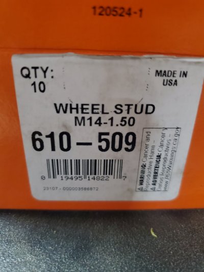

If still looking for longer studs; I found the Dorman 610-509 to be approx 1/2" longer than stock. They fit nice and tight in the hubs as well.
