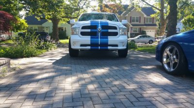

Same here , 1 3/4" BORA's. Zero issues. I did t change my studs or have to cut, but I did use blue loctite. I also drive the **** out of my truck!!!! afc3061032f636e0c465cb40fb68e22e.jpg

This is exactly what I was hoping to hear. Does anybody have pics of their trucks with spacers? That white one looks killer. Can't tell but are those Stock sport wheels?
They are the stock 22" R/T wheels.... Thank you!!

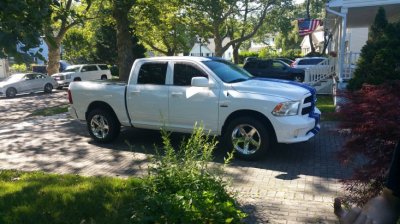

After a much needed bath
B
beveballs127
May 6, 2016
18

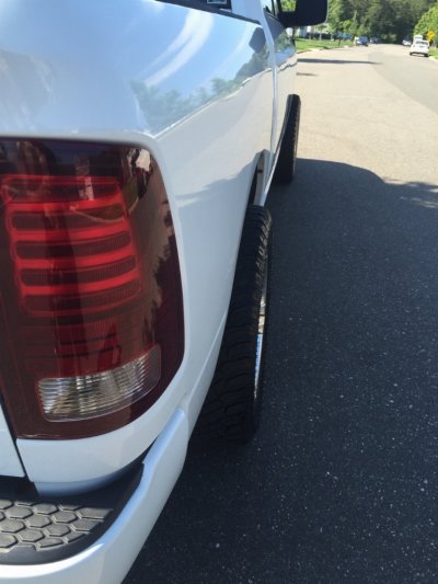

At first I thought 2" spacers were a lot. They are well worth it. Not only does it look way more aggressive but I can say that the corning has definitely improved. A lot less body roll.
