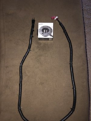

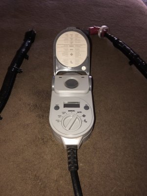

    I just bought a new cord & timer as well as a Noco Genius GCP1 adapter plug for the front bumper - for easy fast plug in.

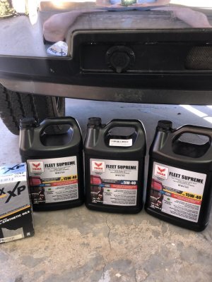

    Putting everything together now as we speak - will install everything this weekend with my winter oil change (Filter removed gives me easy access to the heater element. Also bought a 15Ft 15amp 14 gauge extension cord to keep in the back floorboard.

    Timer automatically activates when temps drop below freezing!

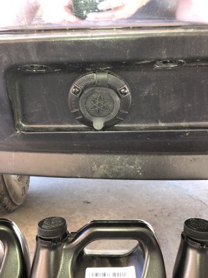

    All done - Winter oil change & New Cord & Plug in Adapter installed!

    Thanks for the I will be adding a plug like your picture this weekend, mine did not have the cold weather package, but the parts I need from amazon should be here on Saturday.
