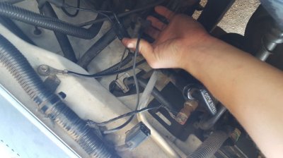

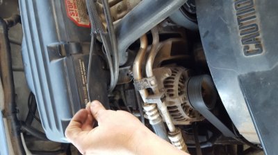

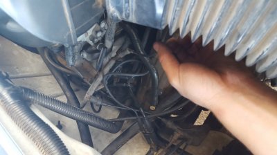

First time on this site so please bear with me. Just bought this truck yesterday (1995 1500 Laramie SLT 5.9) and at first had issues with the oil pressure gauge. A friend and I swapped to a mechanical gauge and my oil pressure is reading correct. This morning the truck started sputtering on acceleration. I knew my buddy broke a vacuum line which I replaced, and then I found this one(In the pics). I don't see anywhere where this would connect. I have it capped for now. I'm going to change plugs and wires and hopefully fix this issue. But can someone please enlighten me and tell me where this line goes? Thanks in advance!

Cruise control line, if it's disconnected on the intake side, it goes in the vacuum tree on the pass side of the intake
