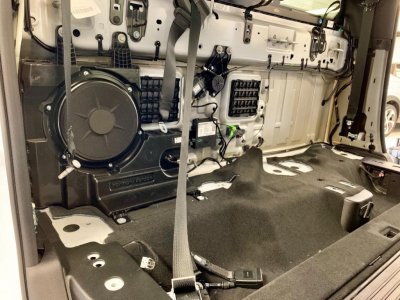

The Sub is behind the passenger side back seat. If you fold down the armrest you can reach behind the seat and pull a shoe lace type cord to fold the back down. You will see the cut out in the carpet for the sub. It has the same enclosure I had on my 2015 with the Alpine system. Reading this thread I see you guys were complaining of sloppy bass? I had none (only highs and mids). I added a Kicker VR 12" and that did the trick. Must say switching from the Alpine to HK was a huge downgrade.

Pic showing the black "shoe string" loop on the rear of the passenger seat that you have to pull on to get the seat back unlatched.
Also shows the sub cutouts on the back wall (cutouts look like mini pizza slices).

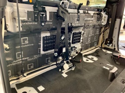

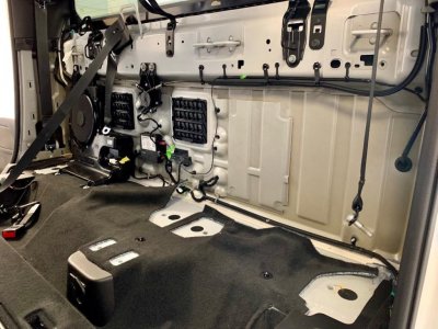

Here are a few pics with the seat out. I pulled the seats and added a roll of soundskins dampening material. This really helped stop the rattling caused by the bass from the factory H/K sub. I also stuffed the sub box with some "black hole stuff" similar to a poly fill.

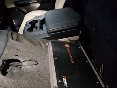

I added an amp as well. I tapped the factory sub wires with a line output converter and ran it to the amp. I left factory sub in place and added a single 12" sub box under the seat. I had to modify box a little so it would be completely hidden under the seat. As for swapping the HK sub you would need a shallow mount sub. There is not much room on the back wall (driver side is takin up by the etec battery).
Thank you so much for posting this pic.....I'm thinking of installing my amp behind the back seat as well....and didn't know if there would be enough room OR if it would get to hot back their.
