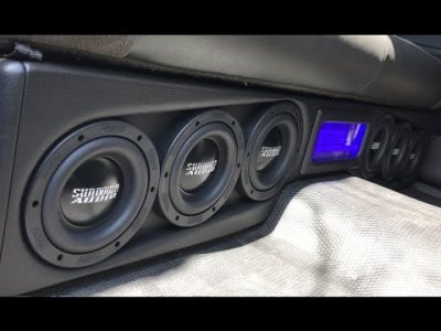

With the floor now flat and open under there i'd love to see somebody put a box in like this. hqdefault.jpg with no hump in the centre it should be an easy fit. Sundown X v2 6.5" subs. Can fit 6 in a 2.0 cu.ft ported box off a 1800w rms amp. Those little suckers make some noise without a seat lift.

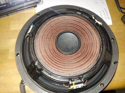

i junk yard scavanged a sub from a 2019 ram to put in my 87 Ram dunno how to wire it..has 3 outputs i metered them out to be 2.0 Ohms..help pls:( heres pics 20190423_185631.jpg 20190423_185659.jpg

Looks like there was 2 wires snipped. Which is positive and which is negative I couldn't say, but meter on those 2 points and I'd say thats where you'll solder you speaker leads. Wiring them backwards just puts them out of phase. Easily corrected if you get it wrong.
