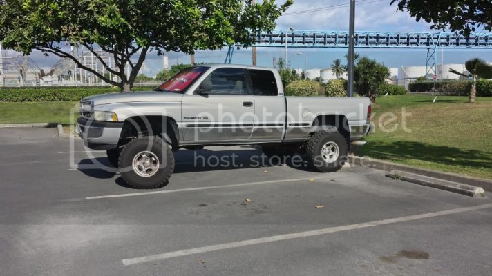

So I just bought a 99 ram. It has 127k miles on it and only 4k miles put on it in the last 5 years. The woman I bought it from is the second owner and didn't know anything about the truck other then her husband loved it but hardly ever drive it. Now it starts up and runs ok. But compared to my nissan titan it's kind of lethargic. Now some of that could be caused by the 35"tires And some by the lack of up keep.
So this weekend I plan on changing all the fluids, spark plugs, wires, cap and rotor (if it has one), fuel filter, and an air filter
And clean up the throttle body. Now a few questions
How do I know what size motor I have?
Engine oil, should I use synthetic?
Air filter, is it worth buying a k&n drop in filter?
Plugs and wires, any recommendations
Then comes the bolt ons, what do I start with? Other then a super charger.
Thanks for any help and advice you guys might have

It's hard to compare a 15 year old truck do a Titan, just not nice. lol But, the difference is that these trucks take a beating and come back for more, quite unlike newer trucks.
You mentioned it has 35s, drop down to 31s and you will see a huge increase in felt power. Besides, that, do as the others have suggested and change the spark plugs, cap/rotor and wires and check the plenum.

Thank you for the info guys. My main concern is that it runs right. Before I start adding the bolt ons. I'm really happy to see that these engines are made for the long haul cause I plan on keeping this truck for a long time. I don't expect it to be a race car but I do want to be able to climb over a log or spin the tires trying. And smaller tires aren't really an option with the 7"lift that is on it. Ill look into the plenum issue and Address that soon since I'm a huge believer in preventive maintenance.
