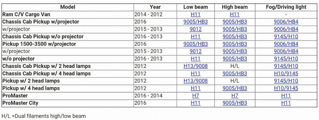

2015 Ram Sport WITH PROJECTOR headlights (are these quad or duals?)
Whats the low beam bulb???

Look in your owners manual, mine has a list of all bulbs in it... mines on page 230.

Thanks, NOW I know what the dual quad difference is.
So do you know if there are replacement projectors? I thought there was a regular halogen bulb behind the projector lens.
