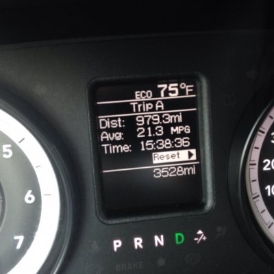

This pic was take at the end of our trip to Minnesota from TX hand calculated was high 19s cruise was set on 78 for 90% of the trip all highway 3.55 6 speed 4wd. On the way back we had bad head wind and made bunch of stops through little towns and averaged 17.5. If you had 2wd 8 speed 3.21 and ran under 70 how you couldn't get 22-23. the hemi does just fine on the hwy it's the city stop and go that really drinks up the fuel.
