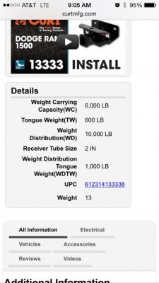

If you look at the rateing that 6k one curt part number 13333 it's rated to 10k with WD hitch technically after 5 we are supposed to run a WD hitch. The 10k towing capacity is for the 3.92 gear ratio and honestly with the light payload on these trucks youll be hard pressed to pull a 10k without being over weight on your truck. The class 3 will work fine for our trucks especially if you only have the 3.55 axle the class 4 is over kill witch is never a bad thing.

For refeense the curt 13333 should be a class 3/4 hitch. Only reason I mensioned it is the fact I had a 06 that put the 13333 on and it was easy to install and $60 cheeper. 19 out 20 times I was below 6k I did pull a 8k enclosed trailer with it. If you are the kind of guy that $60 and a extra hour or 2 is worth being over kill go for the replacement but a car on a open top trailer is under 6k most of the time. If your pulling over 6k consistently your going to want a WD anyways.
