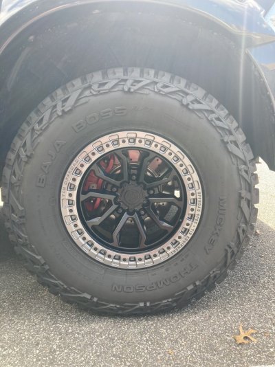

I have a 15’, so don’t know how much help this will be, & not sure how the size you’re looking at compared to a 35” x 12.5” tire.
I had fuel vapors 18x9 with the 35’s & ended up with 1” spacers due to a rub on the uca’s at full lock, the wheels were +1 offset.
I wanted to get rid of the spacers & got some TIS wheels 17x9” -12 offset that don’t rub & sit right at the edge of my fender flares, I prefer the less wheel & more tire look, plus the new wheels were 10lbs lighter per wheel.
Backspacing is a factor too, I don’t know how it’s different from the offset, I’m sure you get some responses that will be helpful.
