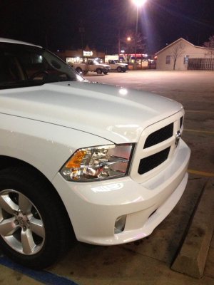

First Time I Clay'd and Waxed:
Crap low gloss finish on the new truck:

Your truck looks awesome WhiteExpress. That's how I want to get mine to look.
