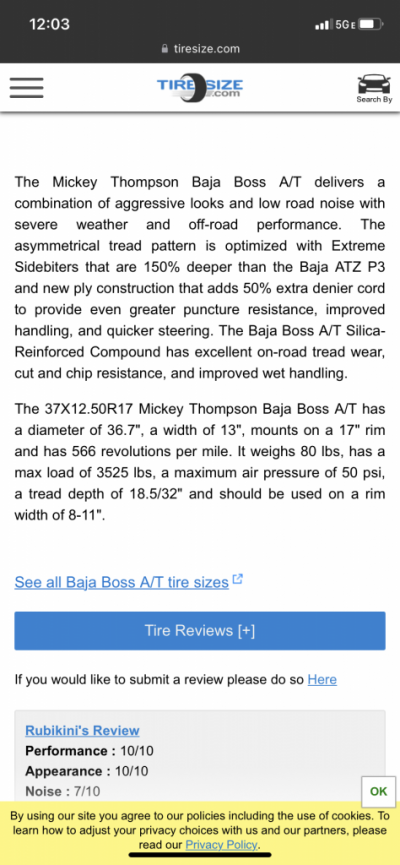

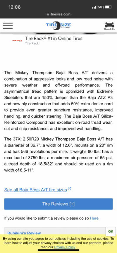

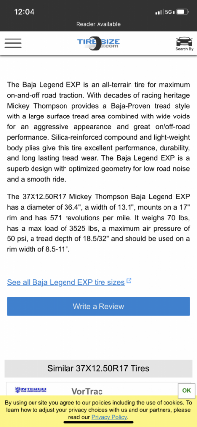

It may help to know what size wheel you have. No tire size is ever true to size. I went with a 305/70r18 on my truck instead of a 35 because most 35s weighed a lot more and were only 34.2” height. My 305 was 34.7” height. Look on tiresize . com to see what the manufacturer spec measurements are

Thanks for the work but it's incorrect a KO2 is 100% smaller than the size they are posting there.
They list the manufactures height as 36.5” for the ko2. I think that’s generally mounted and fully inflated but not on a vehicle. My tire measured 34.7 off the truck fully inflated and on the truck is just over 34”.

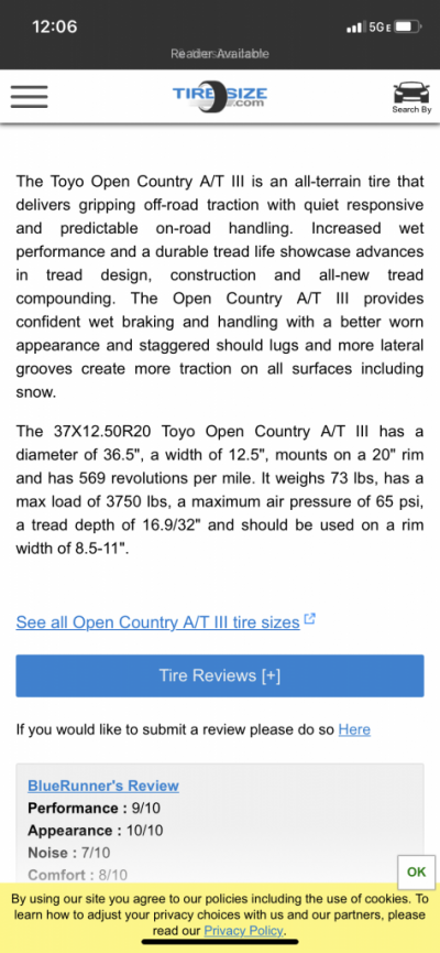

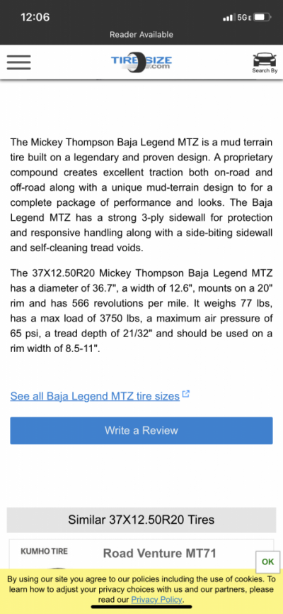

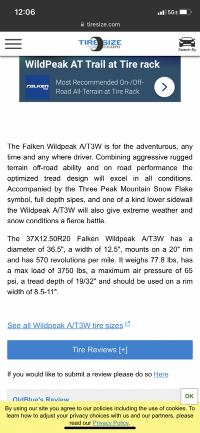

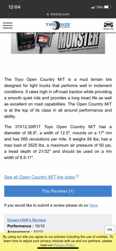

i listed pictures if manufactured sizes for tires. They will always be smaller than the expected ratio height or advertised height and as soon as you mount them to the truck they will be even shorter from the weight of the vehicle. No listed 37” tire will be 37” when under the weight of the vehicle.

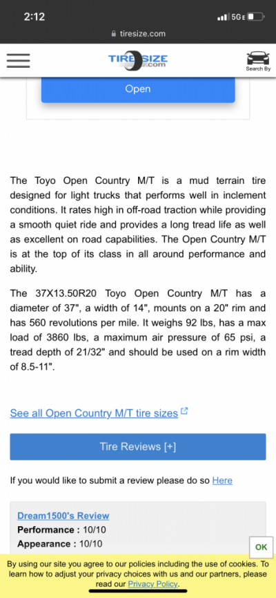

Here. Only 37x13.5 listed to manufactured height of 37” probably measures 36” when on the truck though. You could go to a 38” if you really want a 37” tire

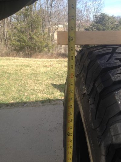

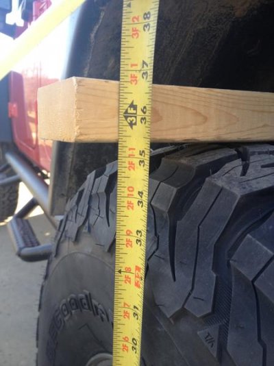

For example, here is a 37” ko2 that was posted by someone on a jeep forum. Under 36” unmounted, and under 35.5” when mounted under the weight of a jeep.
