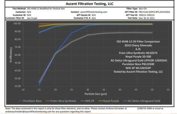

This little graph will show you the results of filter testing for fine particle efficiency...
