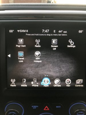

What do you see once you “click” the WiFi hotspot app? I ask ‘cause I don’t have a subscription and get this:

It shows the wifi hotspot name, password, and type of security like WPA2. And the check box of course to enable wifi. It's like the radio isn't transmitting a signal to my phone for me to connect to it. My hotspot name doesn't not show up in my iphone connections list.
