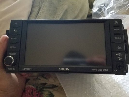

So I just bought this Town & Country RBZ to install on my 2012 Ram.
So will this "OEM" back up camera work with this RBZ?

Yea he said he bought it from someone else and it didn't ask him for the code when he put it in. He also said he updated the firmware to the latest update which turned it Gray theme. Which is the latest 50.01.01 update.
As for the back up cam, why would I need a lockpick? Isn't that just for when you want camera in motion, dvd and nav in motion? I thought the backup camera should just work since 2012s came with them as an option

He also doesn't know the vin from the original car. My truck is still in the shop getting the broken manifold bolts fixed so I can't even put this radio in and try it yet.
But once I do and I'm pretty sure it's gonna ask for the code, if it does, I'm filing a money back request with eBay and paypal.
• 2012 Ram 1500 RCSB Hemi • 22" SRT-10 Wheels Plastidipped Black w/ Bridgestone Tires • Smoked Taillights • Custom Quad Headlights • Opt-7 FluxBeam-X 6000k LED Lows • MicTuning 6000k LED Fogs • K&N 63 Series CAI • Flowmasters Muffler • Line-X Bed • OEM Black Badges All Around • 20% Tint All Around • Lund Tri-Fold Tonneau + plenty more coming soon...
Nope, it's just like all 09 to current RAMs, you have to use the OEM backup camera and have the dealership flash the code. If you go aftermarket, then you use a lockpick to activate the camera you your radio.
***edit**
Looking again at the camera you posted, you might be able to just get the dealership to flash the code since it looks like it comes with a factory style connector on the harness. Most aftermarket ones just end in a RCA plug and that's why you need the lockpick....

If you are considering this upgrade it will work.
The RBZ radio along with other Mygig radios are plug and play (2009 - 2012) in the Ram as long as they are a high speed can bus radio. Low speed can bus will not work.
The camera will work, but you may have to run the harness to the tailgate if your truck is not prewired for it and do the wire hook up to the radio and the TIPM.
For the radio to display the back up camera the dealer will have to flash the radio with sales code XAC. The other route would be with the Lockpick as mentioned in an earlier post, this does not require the dealer code.
