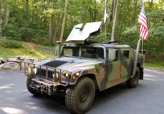

Here is a pic of a M-1026, not my assigned, just to show U in case U did not know what it was, US Military nomenclature: I did not have a m-240 Grenade Launcher on my assigned Humvee, we just had a M-60 Machine Gun.

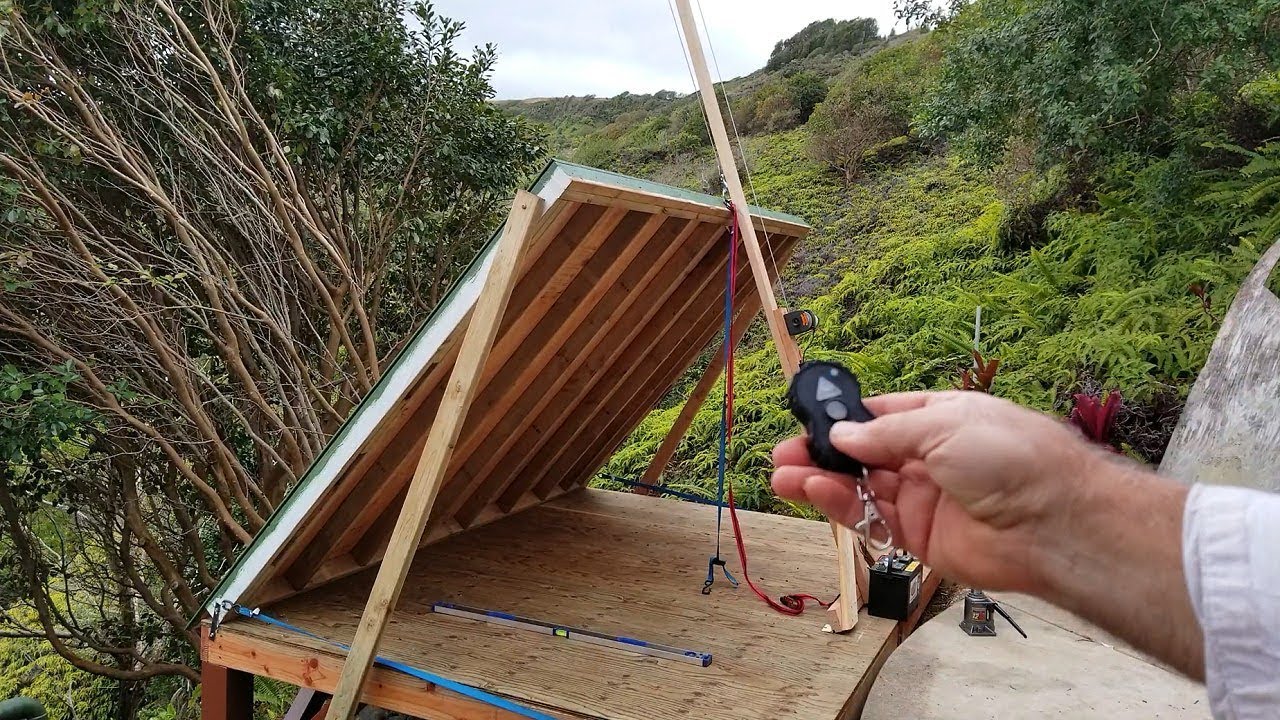

Watch 11 minutes into this video, it is an interesting video, but you asked about raising a wall

At the 11 point of the video that i posted above
The carpenter starts raising a long wall
I do know that you have to set your vertical STOPS & side bracing, before you start to hoist it up
