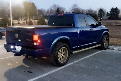

I plastidipped the first year, had kids and ran out of time to do it again. Today’s chrome pvd seems to withstand the elements as well as any top powder coat. I have a couple socket chips from being in a hurry, other than that mine are pristine after 3 Wisconsin winters.
