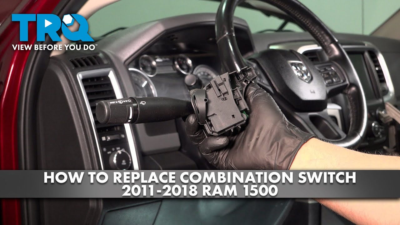

Try searching YouTube for 2019 Ram multi-function switch.
I found the following video for 2011-2018 Ram 1500.
BTW, I've had the panel off below the steering wheel more than a dozen times and never bothered to disconnect the hood release. I don't see the point.
Or search the threads using the search utility in the upper-right corner.
I searched and searched video. The first one I watched is the one you posted. I don't have that housing to remove. Mine is rounder, and has a boot in the front that goes to the dash. I cannot find any screw holes in it to get it apart. I didn't see a reason to pull the hood release either lol

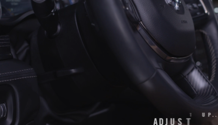

I have, and haven't found anything about my specific cover. Looks like this
If you can't locate anything suitable on YouTube or using the search utility, another couple of options are;
Visit a local stealership parts department with your VIN. I've had dealerships print off drawings for cars and trucks, and rarely paid a cent. Some charged a tiny fee for prints.
Visit your local library and find a suitable Haynes or Chilton's service manual. I used to borrow them from the library, and if you find one that's helpful, locate your own copy using the ISBN.

I've been looking at several PDF service manuals, but have yet to find one with a telescopic steering wheel.
I did watch one YouTube video of a '21 Ram truck, and the multifunction switch appeared to be part of the clockspring assembly. It wasn't a very good video, and the mechanic was only describing the R&R process without demonstration.
I will keep sniffing around for more answers.

Figured it out. The steering wheel must be removed to gain access. Then it comes off pretty simply. Might as well replace clock spring and everything while it's apart. Thanks for the replies
