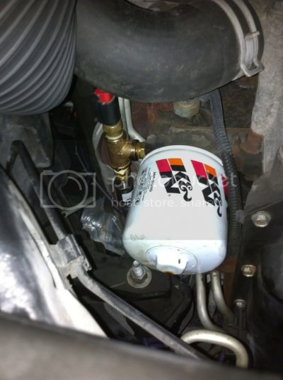

Yes sir and I've heard about t fittig that. I've heard getting a oil filter sandwich thingy lol
BlackedOutHemi
Feb 27, 2011
5,454
198
DFW, Texas
2012 & 2012
5.7L HEMI & 6.7L Cummins
Okay. So, on the oil temperature, basically, pull out the stock sensor, find a tee fitting that goes into that sensors spot, and then put the oil temp on one side and the stock pressure fitting on the other. I realize we have different trucks. But thats how my oil pressure gauge is hooked up.
