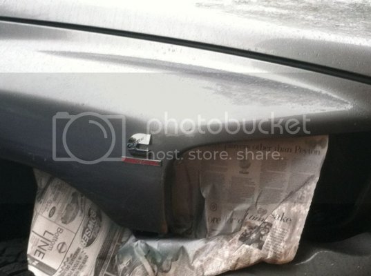

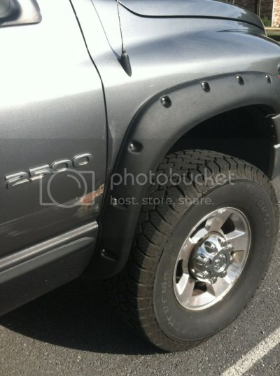

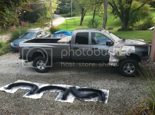

Well I said I would never do it again but I forced my self to do it... More painting
Took the old bedliner off (which really really sucked) and re-did them, much happier with them. Also cleaned up some of the rust spots
This was some time ago
A buddy of mine helped me pull the dents out a bit last summer, primed it and painted it with a gray enamel an covered it with the flare
So while I had the flares off I actually color matched the spots, the paint is a little bit darker but it looks better then rust!
Wasn't to worried about the sharp paint line user the flare. I probably could have blended it a little bit better had I had more time but had to get clear on it an te flares back on to head back to school
Planning on wet sending and polishing it tommorow to try to blend it better
Now I just have to do something with the door and bed corner :Grenade:

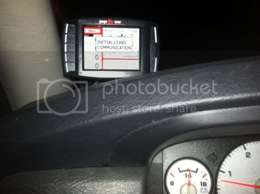

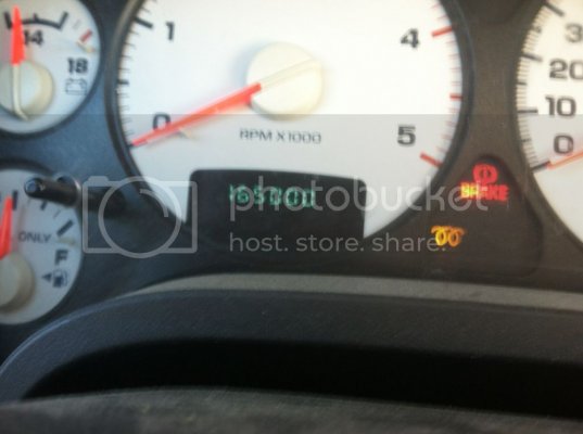

Got a good deal on this
So far I'm not to thrilled about it
Updated it and went to install it and it won't initialize with the truck.
Hopefully going to try it on my buddies powerstroke tomorrow to see if it's the tuner Or the trucks obd2

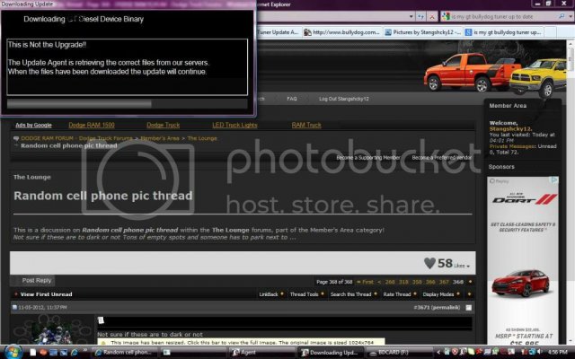

Well here's where the tuners stuck at
Didn't mess with it at all anymore today, going to update it again and try it on another truck here in the next few days

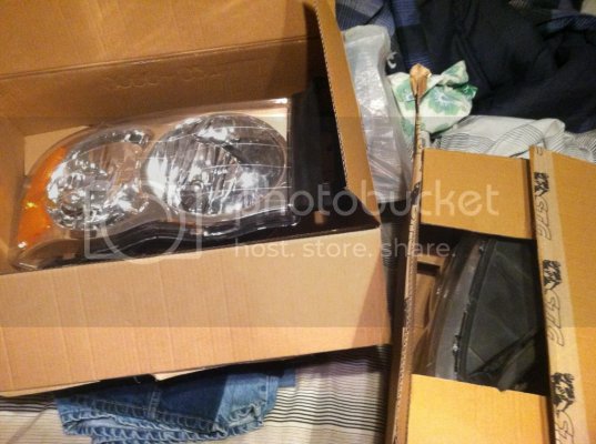

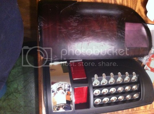

Well came home and these were on my bed :waytogo:
They were supposed to be shipped to my apartment but the guy sent them to my house
I'm kicking myself for buying that tuner instead of projectors, hopefully I can get it working and won't regret buying it
My mom's getting mad at te stock pile of ram lights I have right now haha
I ripped this open cause I was bored
Hopefully I can do something with these this week

Hopefully it'll start working man. My superchips was doing the same thing at first an then after a couple attempts it worked
I really hope so
I tried it on my buddies powerstroke and it gave me an error and wouldn't even switch to the ford settings
I'm home now so I should be able to try it on one of my friends cummins and have the time to sit on the phone with bullydogs tech support

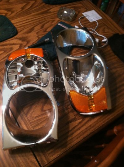

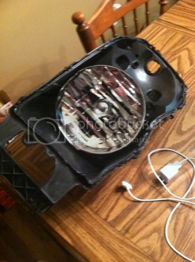

I cant believe how easy it is to open 02-05 lights!
I followed JJ's instruction, 6 minutes at 250* and it took about two minutes to take each light out of the oven and get them apart!
Really wish I had something to put in them though
Any tips for pulling the bulb shroud? I tried wiggling it and pulling a little bit but have made it this far without breaking anything
Can I take it out with out taking the bowl out and do you guys think it would look dumb mineral grey when the bowl is still chrome? Figuring that wouldn't hurt light output
RompinRam
Oct 24, 2011
1,501
102
Hoffman Estates, IL
2003
4.7 Magnum
Bulb shroud takes some force. I struggled at first. Just grip it with your fist as low as you can and rock back n forth pretty hard
