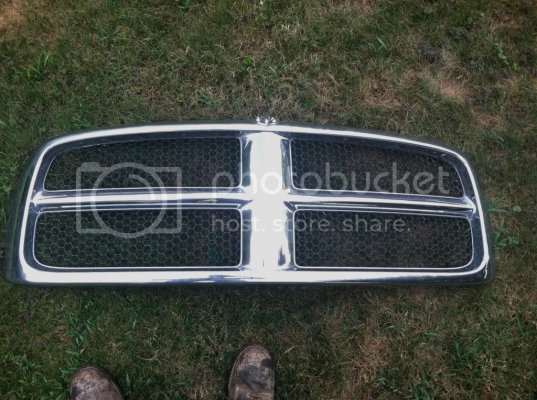

The honey comb looked like it was held on with panels clips (which usually **** me off)

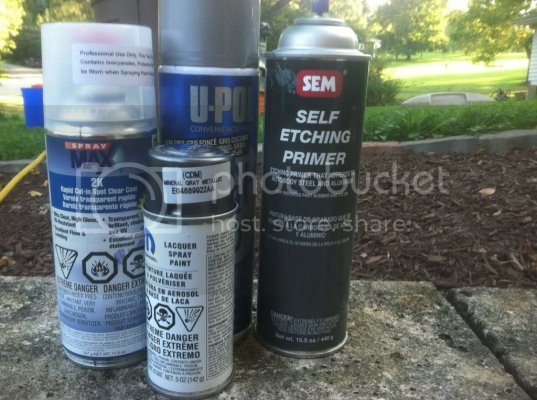

JJ do you think I know you recomended that stuff before but the shelf life had me a bit hesitant
Do you think it would be worth using the duplicolor clear for now till I have the few spots I want to touch up then hit it all with the good clear coat?
I just don't want to spend $20 for a can of clear coat to only use on a grill that I paid $15 for ya know haha

I've use a LOT of clear..........back when I painted.......lol
If you want it to look good from 10ft away, use the duplicolor stuff. If you want it to look great up close, 2K all the way. Yeah, its an activated clear, so pot life is only 24 hours........but damnit, its the ****!

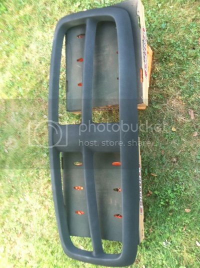

Well you talked me into it, turns out the local parts store carries that clear so I splurged for a can while I was picking up primer

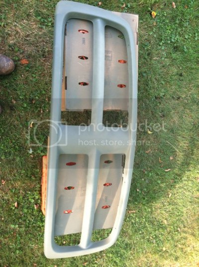

I go a few light coats of etching primer on

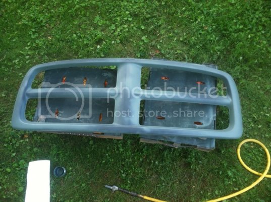

An a few more coats of sand able primer
I finished wet sanding the primer and was hosing it off, grabbed it the wrong way and took a good bit of the primer off so I'll be sanding and priming again tomorow , probably let the paint cure a little longer before touching/sanding instead of reading the directions

get a better clear......that stuff sucks.
I recommend Spraymax 2K clear. Its the ****!
I've never used SprayMax, but I will say Duplicolor rattle can clear sucks!

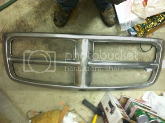

I'm assuming you scuffed the hell out of the chrome first...?
I did, close to 4 hours of sanding
I used a palm sander, another power sander, a red scuff pad wheel on a drill and by hand, I'm not sure what grit I used on the palm sander but it was heavier ten 120
Hard to get a picture of it scuffed but heres a comparison
Better now then later I guess
So far the spraymax can confuses the **** out of me lol
There's writing all over it and most of it is in different languages haha
Best part is they just have pictures for directions

when you are ready to use it, shake it for 2 minutes, push the plunger in the bottom, shake again for 2 minutes, then use it. You've got 24 hours. :D

I've gone a different direction on the paint
I took almost all I the primer back off and started over again
I've been spending a lot of time sanding and respraying and thought I was going to be able to finally get paint on today only to go outside to check on my last coat of primer and see it covered in ash from the fire my dad started...
I'm probably going to make a make shift paint both and paint it this weekend
