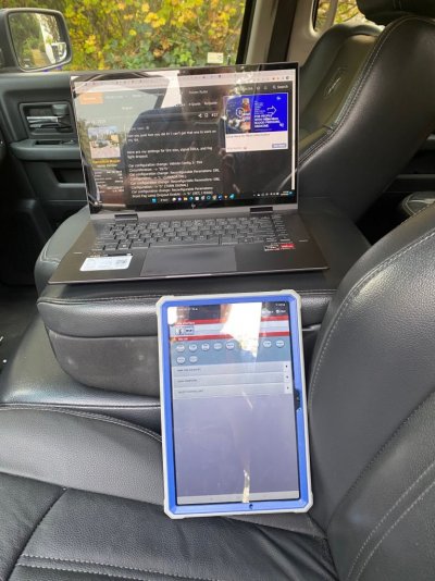

My truck starting to look like my desktop...reading directions from the forum, managing AlphaOBD on the Android device. Still don't have DRL :)1666231634500.jpeg

Just a refresher, OEM DRL operation does not turn on if the vehicle is park/neutral or the parking brake is set.
Did you enable the settings found in the "Known Working" list in the first post of the AlfaOBD thread?
Did you check on the radio if the DRL option is there and they're turned on there also?
