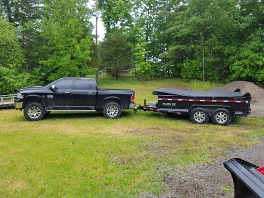

Last install of the day! I put in my airlift 1000 system. It wasn't exactly fun to install but it's in! It was harder to install due to my 1.5" rear spacers for the lift. That compresses the coils and takes up some room inside them. When I put the first bag in it inflated and filled the entire coil. I had to then compress it so I could get the stem protector and line on. That was very difficult. Having the tires off was essential. I learned from my mistake and the second one was easier. Then it was just running the lines. I mounted the stems on the receiver plate but far enough to the sides that I could fill them with air with the hitch and locking pin still in place. With 35 PSI in the bags, the truck has a .5"-.75" increased rake in the back.
Tomorrow if all goes well (bags not leaking) I'll hook up to my RV and show before and after pics. The trailer has a 900 LB pin weight so well see how it looks with the bags!
