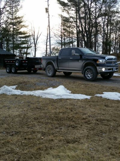

Here's what it looked like in the spring

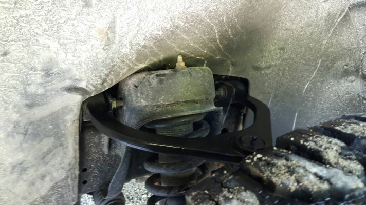

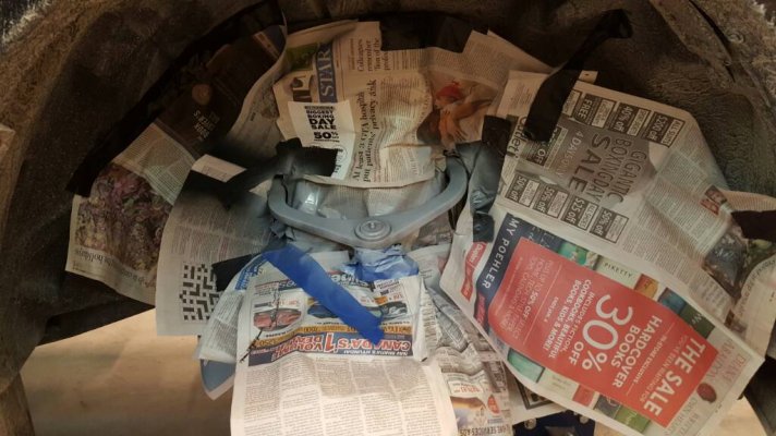

Painted my Mevotech UCA's! Got tired of the rust so I sanded them down, Primed, painted, and clear coated them! 6 coats total.
Before:
Primed :
Painted:
Finished!

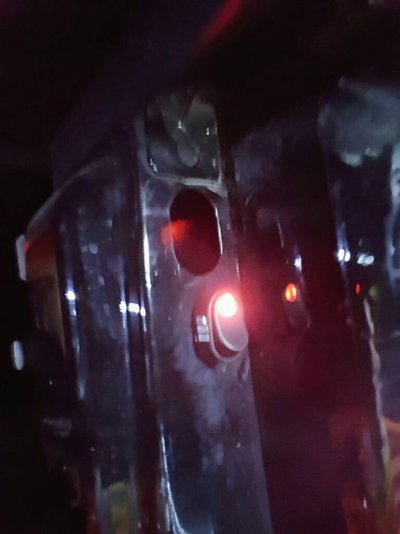

So a couple buddies of mine opened a LED Lighting company up here in Canada, Reckless Industries. They hooked me up with a 50" curved LED Light bar for my truck! We mounted it underneath the bumper. I've attached pics of where the mounts bolt into. The 50" curved fits perfectly in there! When we took the wind deflector off there just so happened to be 2 holes already in the frame exactly where we needed the mounts to go! All we needed to do was bolt them in.
Next we mounted the light bar and wired it up. I used a SPDT (on/off/on switch) switch so that I could have it on when the truck is off, off completely, or on when the high beams turn on. It works like a charm!
