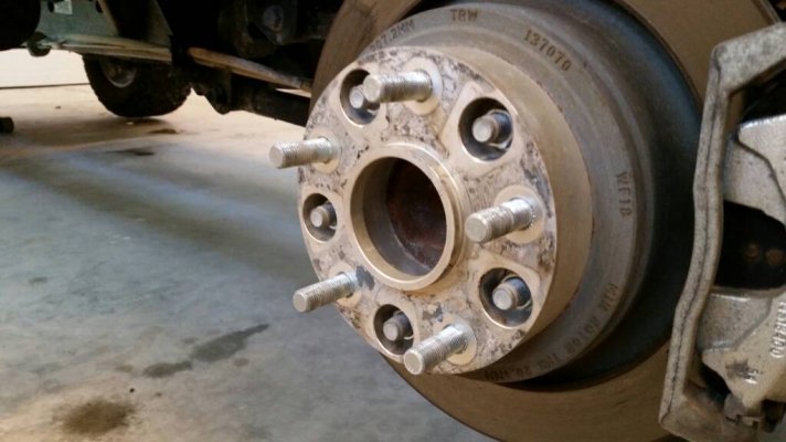

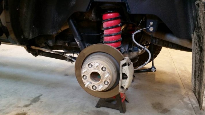

Here's an update on my BORA Wheel Adaptors. I rotated the tires today and retorqued the wheel adaptors at the same time. None of them needed to be tightened! They were all nice and snug in there. The adaptors look great to for having to deal with all the salt on the ontario roads this winter! All the dirt and stuff on them would have just rubbed right off, I just didn't have the time to tackle that today as well lol.

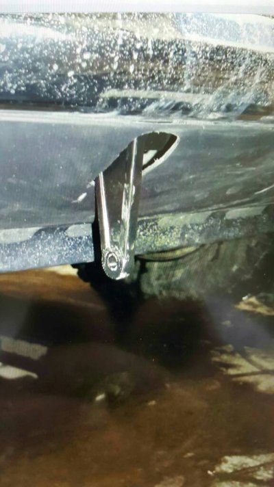

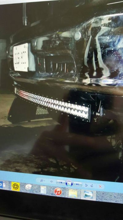

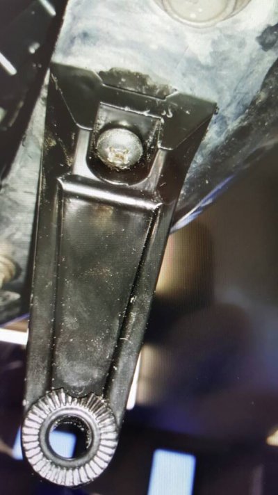

The bar mounts are bolted to the bottom of the bumper where it curves underneath. I have the steel bumper so it holds it nice and secure! Here's a couple pics:
All we needed to do was take off the air dam and we were good. There were 2 holes in the bumper there at exactly the right spot on either side! Who would have thought?! We just put the bolt through them and tightened it up. I can't say there will be holes on every truck, but there were on mine.
Next we made some measurements and cut holes in the air dam for the light bar mounts to fit through.
After that we mounted the light bar and ran the wiring.
We used an SPDT switch so that I could have it on with the truck off, off completly, or on when the high beams come on. It works great!
I had to take pics of the pics lol. I've since bought a new phone so all these pictures were on my computer!
