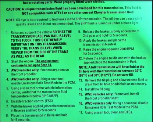

Just fyi....I changed out, did not flush, the transmission fluid last year. Purchased pan and filter from O'Reilly. Got the wrong pan to start with...it was the shallow pan...returned it for the deep pan. Purchased oem fluid from dealer...very expensive...I think I was able to replace 7-8 quarts. THIS IS THE IMPORTANT PART, be sure and level the transmission prior to refill to get the proper level. This involved jacking up the rear of the truck quite a bit. Just be advised the pan needs to be level and at the right temperature to get the proper amount back in. Not hard Just seemed weird jacking the rear up that much...up will have to crawl under the truck so make sure it's secure and front wheels are chalked.
