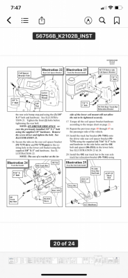

any update on this?? I have a procomp 4 inch lift with coil spacers that also relocate the track bar. im trying to get 3inch coils but if I remove the coil spacer it will mess up the track bar so im at a loss of what to do

I already have a pro comp complete lift kit with everything but I would still need to buy the complete zone rear box?
I thought you were wanting to ditch those spacers........are you trying to stack 3" coils on top of your 4" spacers?
im trying to ditch the spacers and go to full size springs instead.
When you ditch the spacers you'll also be ditching your bumpstop spacers and losing the rear mount of your track bar bracket since it attaches to the spacer. The kit provides all of those items.

Just going to throw it out there but I have a full zone box kit with 3 inch coils sitting in the garage brand new never used. Straight from zone. Opened for pictures then taped back up
